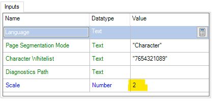

After exhausting all the other avenues, I decided to look closer at the Tesseract Engine options that we can set as part of the Read Text with OCR Read action, particularly in this specific order:
Environmental Conditions & Disclaimer:
The experience published below is based on the following circumstances:
And therefore, what I've shared here is limited to my experience of getting past the challenges I faced in this environment, and you will need to play with these options before you can exact reliable performance from Read Text with OCR!
Try these helpful options:

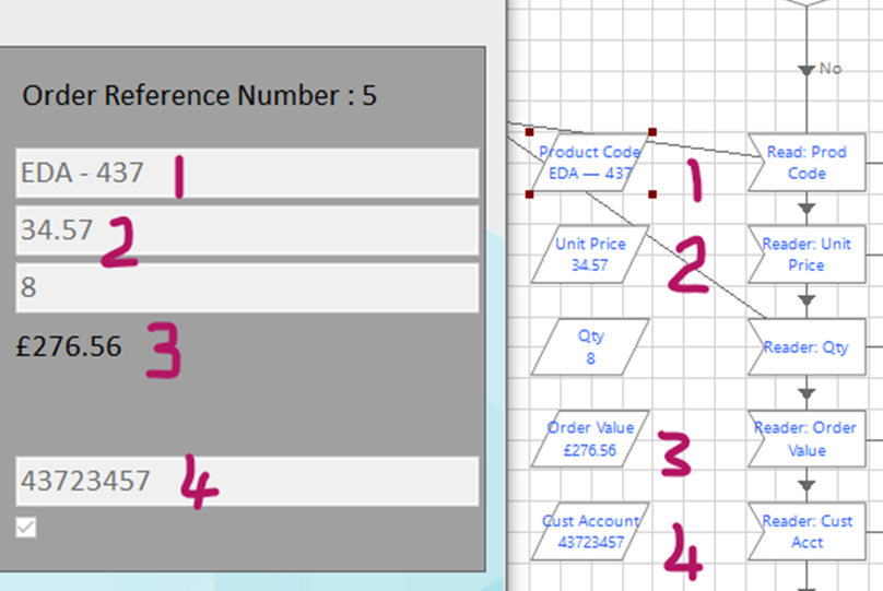

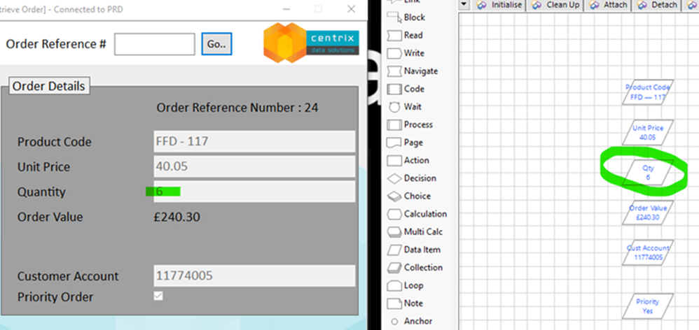

A few screen shots published below show the end result. And I'm hoping that these options will help others as a starting point.
Summarization:
Scale |
Page Segmentation Mode |
Character Whitelist |
Notes |
1 |
2 |
Line |
Worked for alpha-numeric-symbol data on Gray scale. Example: EFD-702, EDA-437,CFF-908 |
2 |
4 |
3 |
2 |
Character |
0123456789 |
Worked on whole numbers on Gray scale. Example: 7, 8,10,1 |
4 |
2 |
Line |
0123456789 |
Worked on long string numeric data. Example: 43723457, 90895989 |

Observation: All data where 7 appears in various formats have been read reliably
Observation: Single-digit whole number data has been read as expected
