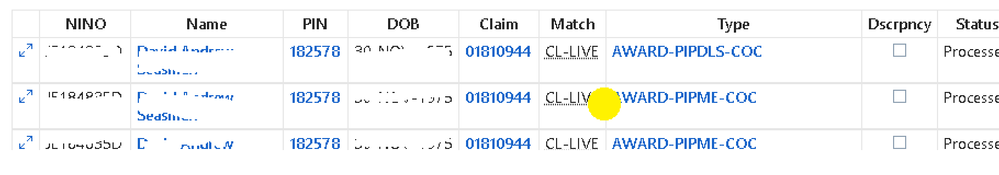

Now, I'm trying to read the tables within the front-end user application and some are fine as they don't contain a Show All/Hide All function within it but some do....
This is an example... (With Sensitive info hidden/obscured)
Now the problem I'm having is that if I use the UIA Get Rows function after spying the table successfully and place it in a Read item then I get the following message:
Internal : Failed to perform step 1 in Read Stage 'Results Found Table - Reader' on page 'Extract Batch Table Information' - Value does not fall within the expected range.
And if I use the AA Get Table function within the Read Item then the table reads but each row is all crushed together and totally unusable as the info would change.
I assume that the reason for the initial Error message when using UIA and Get Rows is that the initial column as shown in the Image above is an actual hidden expansion tool and so will not allow the table to be read as it causes confusion however my problem is that these use to be present and be read without issue before it was the upgraded software and also on IE not Edge....
I really don't want to use Surface Automation as this would be probably extremely time consuming and also no work when previously the old Get Table worked brilliantly.....
Can anyone shed light on how I can simply extract all of this information using UIA Get Row or something similar?

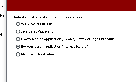

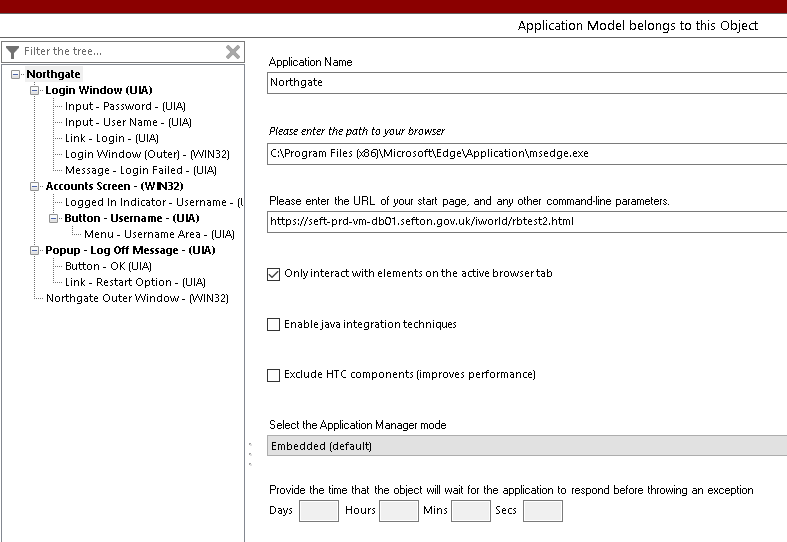

Now I'm not sure if the App Modeller has been set up properly, but originally the only way I could spy elements within the App Modeller was by using the following:
Plus
(I know that the IE is wrong but this was the only way to spy elements within the Application)
This is where I am facing the problem.
If I make a new Object but using Browser Based Application (Chrome, Firefox or Edge Chromium) then all the spying options are available and UIA , WIN32, AA, and Region work, but Browser mode is present but when you select it then nothing is spied....

Application modeler does look strange to me - you are launching edge but you are selecting IE browser mode in BP. That should only work if you are launching Edge into it's IE compatibility mode which is basically an embedded IE within Edge that MS are going to keep supporting for years more. I don't know off the top of my head how to launch into that mode within IE - should be findable if you google for it, presumably either
Our recommendation on moving your interfaces from IE to Edge is to use Edge compatibility mode if you want to keep using the same interfaces (built in HTML/Legacy browser mode) but there may be some tweaks needed if your testing find issues with it. The other more expensive option is to rebuild everything from scratch in Chrome/Edge browser mode.
I'll attach a draft doc (not an official Blue Prism doc) that gives some info on using IE compatibility mode - maybe give that a try if you are not going to rebuild interfaces from scratch using chrome mode.

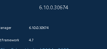

Many thanks for your reply. We are currently on the following:
So I had previously downloaded and installed
Blue Prism 6.10 Browser Extension as the next one was 6.10.1 and were not at that release yet. I have removed it and reinstalled the Extension and it is showing its icon next to the Edge URL address bar, but when I plave App Modeller into Browser mode, its still not picking anything up. I've have tried this also on a plain Google page and still nothing?
