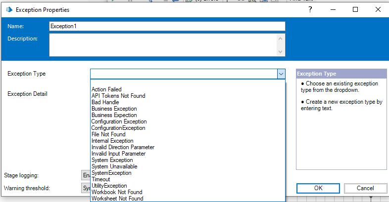

Hi
I have started working with exception stage in LMS course it shows all the exceptions in the exception dropdown and even in system under process & Object Exception others are able to see the exception types but unable to get them can anyone help me out please.
Thank you
H Gahlot

Once you drag and drop exception stage then in exception type you can able to see all the types even you can define a new one.

17-05-21 01:28 PM
ya, I am aware of that but in drop-down am unable to get it that's the reason I have posted a message if am creating am getting it but without creating alose we must get them in drop done right.

17-05-21 02:25 PM
Hi
It will appear once you create. You have to create once then it will appear always
PFA here

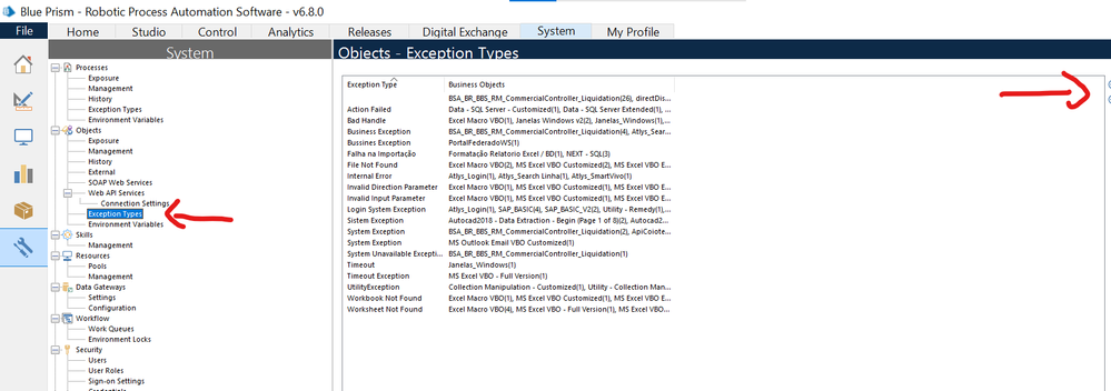

17-05-21 02:32 PM
You may also be viewing the types and what objects they use in this Objects -> Excptions Types -> Scan Objects.

19-05-21 02:28 PM
Would I be correct in assuming that you don't have any existing processes or objects in your Blue Prism environment? The only reason your Exception Type dropdown can be empty is if there are no existing Exception Types in your Blue Prism environment already. The only way they get added is by creating an Exception stage inside of a process or object and then manually typing a new value into the Exception Type field of the Exception stage. Once you save the process/object with that Exception stage in it, then other processes and objects will be able to see that new Exception Type you added.
If you were to import all the VBOs from the Blue Prism Automate folder's VBO folder, then you would automatically have a bunch of Exception Types listed in that drop down.
