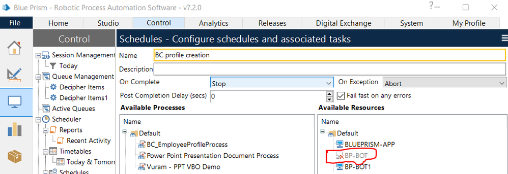

Hi All,
I am getting same issue Runtime resource( BP-Bot) showing offline in control room. Below is the screenshot. Can any one help on this. I have restarted but still same issue. But another runtime resource( BP-Bot1)is showing always on line
Pralay
Pralay Das

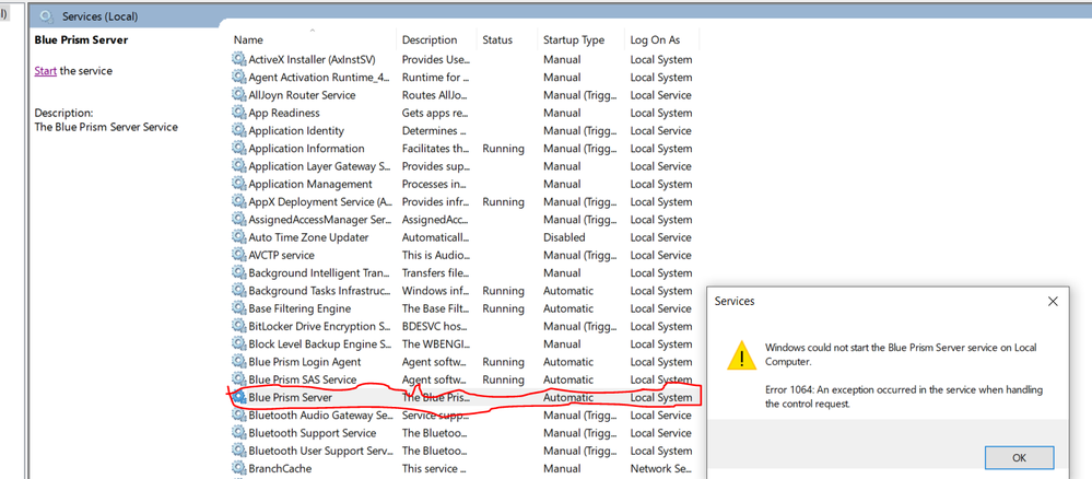

Also when I am trying start BP Server getting bellow error message.
Pralay
Pralay Das
