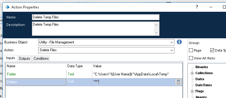

Hi @Mary Culotta,
Below Steps can be implemented in the ​Action Stages (Delete Files).
1. %temp% --> This cleans the temp files of the User Profile --> Username must be selected dynamically in a data item.
2.   temp --> This cleans the windows temp files. The RTR or VM must have admin rights to run this command.
Or, you can create a .bat script to add such commands and then execute using Start Process Action stage.

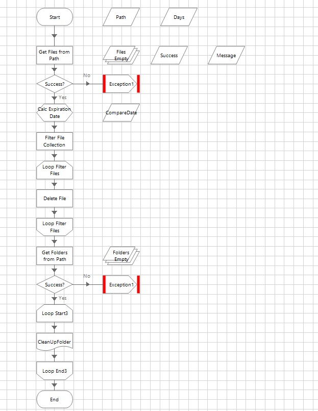

In my opinion, its really hard to make this only with the BP Tools and I do not recommend to put this kind of maintenance task inside a Business Process.
But... challenge accepted!
Attached to this message you have the full project that I made. Basically, import it (also need to have Utility - Collection Manipulation and Utility - File Management)
How its works? Just call the action "Housekeeping" from the object. You need to indicate the folder that you want to clean up and the number of days that you want to delete (If you put 180 its start deleting files older than Today()-180 days)
Its also delete files in subdirectories from the first path. If you open the Object you will find a page called "CleanUpFolder". In the last stage calls itself (recursively) to go inside every subfolders. (If you have some problems to understand this kind of recursive functions, tell me and I'll explain you better)
This is how the CleanUpFolder page looks like:

​Hi Saurabh,
Can you explain a little more how I use the %temp%.
Thank you
Mary Culotta
Hi @Mary Culotta,
Sorry for the late response.. I was trying to explain as shown below for cleanup using %temp%.
Step-1: Get the Username
Step-2: Delete files by giving %temp% file path. Sometimes this step requires admin access in the VM...to properly execute this step.
You can check the same by manually doing this step first... Admin access on the VM depends on the roles you have been provided by the Infra owner.
