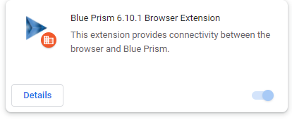

I have confirmed that the Chrome extension is installed, enabled, and functional (because other websites work and even the initial page for this site works, too).

Did you check if you are using the same version for your Chrome browser?
As suggest in the documentation, for BP 6.10.1, you need to have install the extension with the same version, and is compatible with Chrome 88.x to 98.x.

Thanks, Pablo. Yes - the extension version matches.  Also, I'm able to spy and interact with other websites and even this one on the original window.  My bot just can't identify anything in the subsequent windows.
