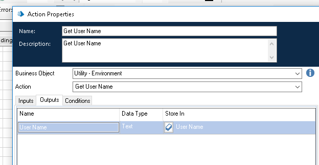

This is how the CleanUpFolder page looks like:
