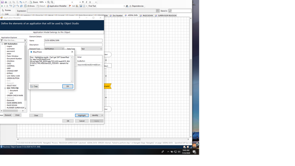

  • Using DEV2 connection for automation
  • Logging into SAP with my user credentials and have tried PRD and R3Q connections
  • Sap spy mode is not highlighting anything
  • Accessibility is enabled in SAP client-side
  • Scripting is enabled in SAP client-side
  • RZ11 transaction has already been completed on the server- side
  • Able to spy with the other modes but once you press the save button and try to run it in process the error is "unable to match any windows with the query items"
  •  I am unable to successful run the process that was previously working fine with SAP mode previously highlighting.
What else can be done to fix this issue. As stated when I try to use other spy modes it the object will work but when I save and move on then go back to another page I get the same error that it cannot match query items.

​THIS IS THE ERROR
Error - Highlighting results - Can't get SAP ScreenRect for /app/con[0]/ses[0]/wnd[0]/usr/tabsTAB_MAIN/tabpTSCLASS/ssubSCR_MAIN:SAPLCTMS:4000/btnOES_PDOWN - element not found
Whenever I try to respy SAP MODE is unavailable it shows the pop up but will not highlight anything in the window.
So I try to spy with other modes.
Which works until it is saved and then it disappears.
