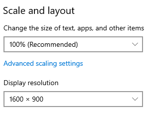

We have seen this in the past; the recommendation is to lower the resolution.
Please try using 1600 x 900; at less, that works in my case. But try changing your resolution until it works fine.
Also, try to use 100% in the Display settings for Scale and Layout.
