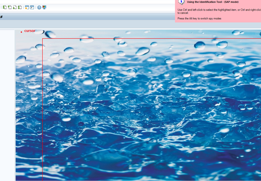

I have a problem with the Identification the elements in my SAP Window during use the mapping tool.
The problem shows up in the inability to accurately mark elements. When I mark a element with my cursor the red frame appears in the incorrect place (see image).
I use BPDiagnostic but the same problem exist in the Application Modeller.
The problem occurs only in SAP mode.
Thank you!

We have seen this in the past; the recommendation is to lower the resolution.
Please try using 1600 x 900; at less, that works in my case. But try changing your resolution until it works fine.
Also, try to use 100% in the Display settings for Scale and Layout.

MarekMiensok
Thank you!
