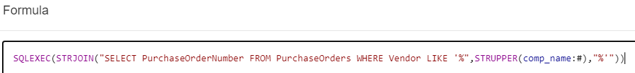

Ok, it's a tricky one using the LIKE and STRUPPER. But I've got it working as follows:
SQLEXEC(STRJOIN("SELECT PurchaseOrderNumber FROM PurchaseOrders WHERE Vendor LIKE '%", STRUPPER(Vendor_Name:#), "%'"))
To get the STRUPPER working I had to add the Auto-Calculate flag, which isn't usually needed for a dynamic list.
Have you tried adding that flag?
Ben

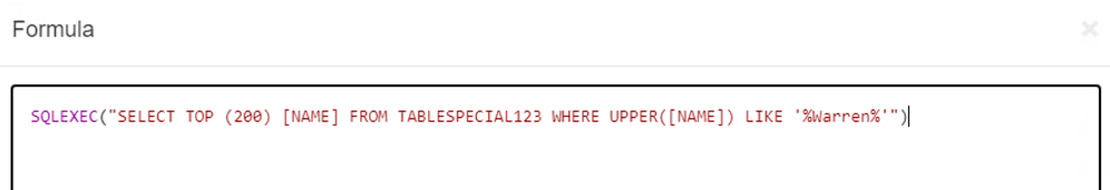

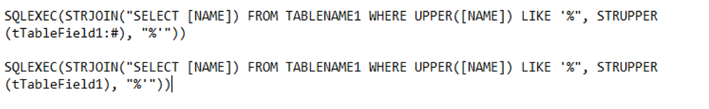

KalashSharma
I have tried both of these below mentioned SQLEXEC formulae. They work fine on the fields (after replacing tableField1 with normal field) but NOT on the tabular fields. If this is the limitation of Decipher please let me know I will think of the alternative.
Ben

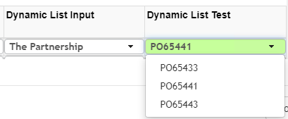

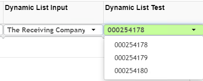

BenLyons
Hi Kalash,
It's working fine in my set up, so worth looking into your access/configuration. (see snips below)
