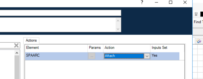

SasikanthMachav
Hi Tracy,
It seems you need to attach the target application using Navigate stage. PFB the screenshots. You can also mention window title & process name as well for the accuracy.
I would suggest you to use Attach action before performing any action on target application.
Hope this is useful.
