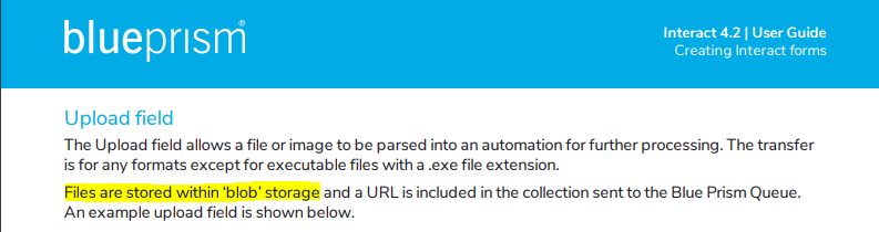

The only useful information is the URL that communicate Blue Prism into the collection after the file is correctly uploaded.
Into the BluePrsim's guide, the only reference i found about it is:
So, where the uploaded file are saved specifically?

Hi Ambrogio
The file isn't stored in a database, it is stored within the hub web server. As a default, the path for this folder is "https://file.local/Files/self-serve-private/". The uploaded file is also assigned a GUID as part of the Upload File VBO to ensure that files uploaded with the same name are unique.
For example, here I have uploaded a file called "image.png" and the link received from the VBO is "https://file.local/Files/self-serve-private/image.ad21bb40-82f4-4fdc-99ab-d7e07fd080cb.png".

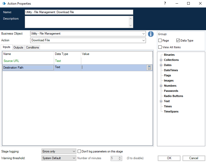

I have a query here, user uploaded a image through interact form and in the blueprism process i got the link to the image like you have shown above but i want the image to be downloaded to local for further processing and how to access the path to self-serve using file explorer as i am not able to find the self-serve folder in my local.
Upload file action is being used for uploading a image to the form or downloading the image from form?
I have used upload file action for downloading the image but getting the below error

Hi Salman
You need to use the Download File action in the Utility - File Management VBO. If you use the link for the uploaded file in the Source URL input, you will be able to download it to the destination you specify.

Hi @Joe Farr,
As you said i tried with the Download File action its working fine

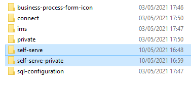

  1. I got the link from queue data by using the link can we decode the path or else can we go to the specific path (where the file is being saved by Interact) like we go to the files in our local drive and copy the file to local drive for further processing? How to manually open the folder path (self-serve/ self-serve-private) like shown in the below screenshot?

  1. It's no longer possible to navigate to the folders as Interact now saves them to the Interact File Service. The link provided is where it is saved in the File Service, meaning that the file can be accessed by another user with access to the submission in Interact or by a Digital Worker running a process. Download File then gives you the ability for the Digital Worker to save it in a location you specify, or to refer the form to another user for them to download locally.
