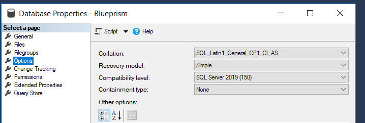

Plus you can check in your SQL Server  Database properties that the Recovery Mode lshould be simple, not full, becuase the full recovery writte all of transaccion an increise a hug
