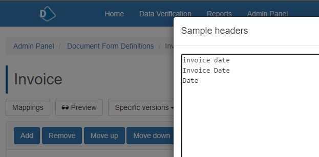

Since fields are the same across all vendors I would say take a batch of 50 invoices from different vendors and see how it goes.
Also, ensure you have proper Sample Headers set up in the DFD so Decipher can grab the data accurately irrespective of the field position on the invoice.
Include all possible sample headers that you come across.

18-05-22 09:23 AM
Great sharing of advice here guys.
I'd just like to add 1 small note. Sample Headers aren't case sensitive, so you only need to have "Invoice Date" once and it can be as mentioned or "invoice date" or "INVOICE DATE". They will all work the same 👍
