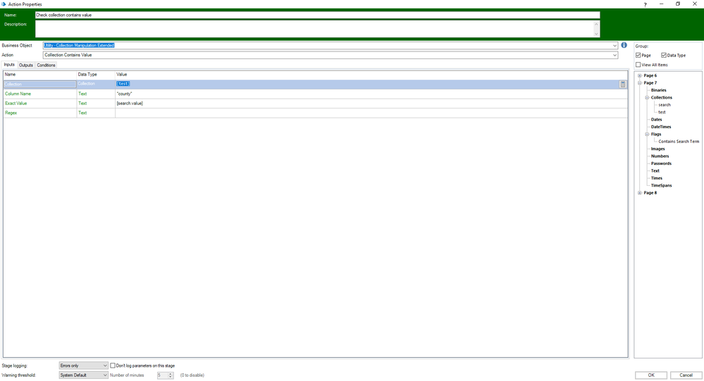

So I have this collection that is [test] I am trying to determine whether [test.county] contains one of 80 possible test strings. At the moment I have a decision stage with
[test.county] = "test" OR
[test.county = "test2" OR
for all 80 of the possible text strings. I was wondering if there would be any way to more efficiently do this rather than the 80 separate OR statements.
If anyone has any feedback or ideas for this please let me know, thanks in advance.
Jari Carlson
michaeloneil
Hi @Jari Carlson

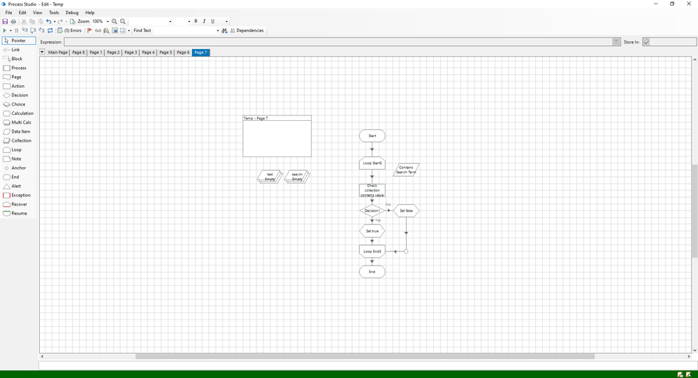

I would use the Utility - Collection Manipulation Extended and the action Collection contains value. This will let you set the collection you want to search, the column you want to search in and the term you need to search for. If the 80 values you need to search are static then add them to a collection and loop the collection to search for each term. Screenshots below.

michaeloneil
Hi @Jari Carlson

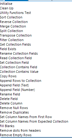

Do you know where to find the utility Collection Manipulation Extended? I have looked around and done some googling but I can't find anywhere that mentions that as something that is available through official means.
Jari Carlson
Hello, Jari.
I hope you are well.
Below is the list of actions:
