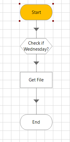

Hi guys,
I want to use Blue Prism to check what date today to run process.
My idea is if Wednesday - Yes - Get file A to work on. Otherwise, No - Get file B to work on.
I have used the IsDate function but seems like it doesn't work.
Can you please help me with this? Many thanks!

10-01-24 10:35 AM
Try this decision
FormatDate(Today(), "dddd")="Wednesday"

10-01-24 10:35 AM
Try this decision

10-01-24 06:58 PM
Thanks guys!
