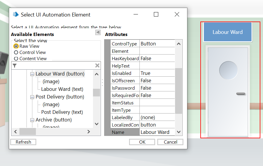

Hi @Saransh Saxena - Just to double check - have you tried doing - Open UI Automation Navigator and check for elements in there ?

Yes , I have checked the Open UI Automation Navigator for elements, it only contains Menubar, Titlebar elements.

Hi @Saransh Saxena - I have tried doing - Open UI Automation Navigator - Switch to Raw View - Typed in the Element Text and was able to check the element/Highlight the element.
Just in case - can you open other windows app - for e.g. Calculator and check if that works with UIA/AA - I just wanted to be sure if this happening for every windows application or just this one ?
