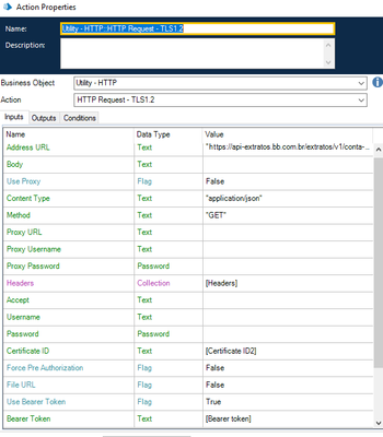

My problem in this case is that I can't make the mTLS connection.
I'm using the object Utility - HTTP available in the latest version and it doesn't have a step to make the TLS connection.

jaqueline.souza
To complement, here are the parameters I am using in the request:
