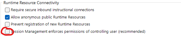

28-08-21 10:39 AM
Hi Steve Boggs,
Thanks for your reply, i got the solution i have un checked the checkbox.
After that successfully creating the sessions and running the sessions from Http interface.
