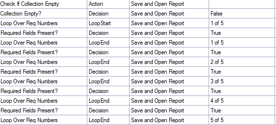

The Save and Open Report page downloads an Excel file and then enters the relevant information into the web browser to create a Purchase Order. When I send an order to the Test machine, it will loop through the extracted report and create 5 orders (for example).
However, when I run this process in Dev, it will only show 1 of 1 even if there are more lines to select.

And yes, you understood correctly. The bot deletes the Excel file after the information has been extracted, but I ran the bot in Prod and stopped it at the stage when it downloads the report. I did the same thing for Dev and found that the files really were only one line in length.
Our Oracle Dev environment is a little different from Prod; in Dev it will search through a list of requisitions, but I was confused by the UI. I was seeing an entire list of requisitions and thinking that they were included in the Excel file, but they weren't. The bot was working as it should, it's just that I didn't realize Oracle was showing more than what the bot was looking for.
