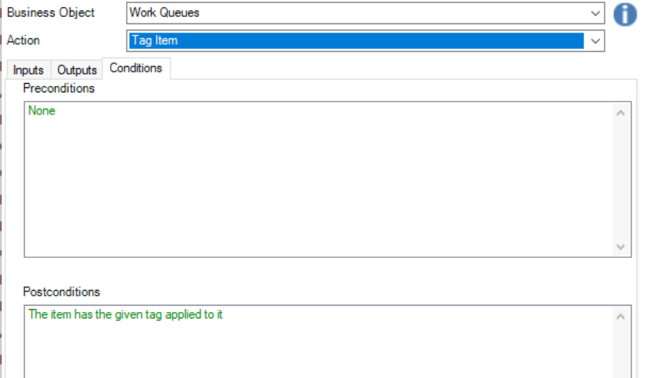

14-04-22 02:33 PM
Hi Pablo,
Thanks for your help.
I am facing this issue in the v6.10 environment and there are no any preconditions for the 'Tag Item' Action stage. If I use 'Update Status' action stage then yes I will get the above error since 'Update Status' action stage has precondition that "The item must have been locked by this process", but for 'Tag Item' action stage there is no such condition so this action stage should work in any sub process without any issue.
Correct me If I am wrong.
Amaresh
Amaresh Gadagin
Amaresh
Amaresh Gadagin

14-04-22 05:12 PM
Hi Amaresh,
I would suggest you to not go by Pre Conditions as they are not automatically generated and are usually maintained manually by the development team whoever is responsible for building that action so there is a high chance that they might forget to update it since I myself have faced such issues so many times in past.
As a thumb rule, what I have observed is whenever blue prism works on any kind of an update for any work item (Status, Priority, Tags etc.), it locks the item and gets the item ID from the back end database. So if in any action, you are passing Item ID then be sure that it is going to use the same concept which I explained in the post.
