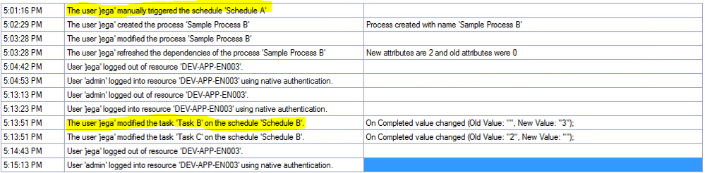

Hi Kristian,
Blue Prism does log the following actions under the Audit Logs.
  • The user who starts a process manually by executing run now from the scheduler.
  • The user modifies the process under the scheduled task.
What's the current version and architecture of Blue Prism that you're using? E.g., Blue  Prism 6.10.1 (64bit)

Everything gets captured in the Audit log table of the database (BPAAuditEvents).I recommend you to export the Audit Events from the command line interface using the "getauditlog" flag, for example:
c:\%Blue Prism Installation Folder%> Automatec /getauditlog /from 20211201 /to 20211231 /user username password
You can also write a script to use /getauditlog command and push that data into the Windows Event Viewer.
