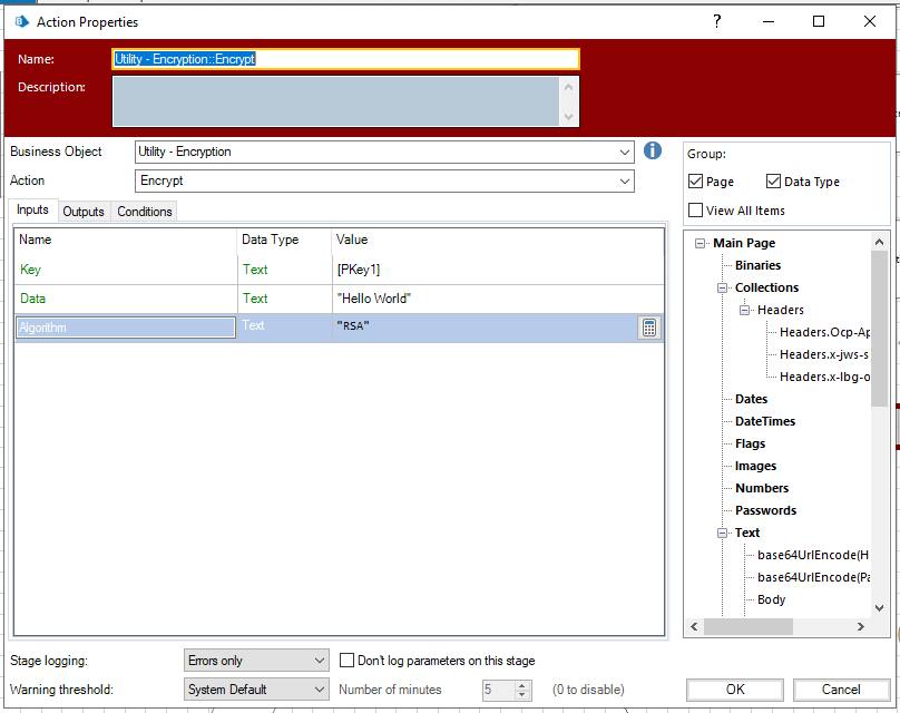

I am having an issue with the Utility Encryption VBO, and was wondering if anyone has any ideas or suggestions?
I have the inputs to the VBO set up as per the below:-
I am receiving the below error when I try to encrypt my text string.
I believe that this is to do with the length of the text string I am trying to encrypt (approx. 300 characters) as if I enter the below, this works fine:-
From trial and error, it seems to me that the VBO will successfully encrypt  and text provided up to 214 characters, when trying a 215 character string, the below error was generated, and any string over 215 characters returned the 'Bad Length' error

With that said, the RSA algorithm is limited to how much data it can successfully encrypt, and that length is tied to the length of the key too. It looks like you are supplying your own key, correct? If you provide a key of say 256 bytes (2048 bits), you should be able to encrypt up to 245 bytes of data. With a key of 128 bytes (1024 bits), you could encrypt about 117 bytes of data.
You can calculate the maximum size of the data that can be encrypted, based on the size of the key, using the following formula:
((KEY_SIZE_IN_BITS - 384) / 😎 + 37

@TonyHann,
After looking at the code, the actual call to the underlying RSACryptoServiceProvider.Encrypt() method is using OAEP padding as opposed to PKCS#1 v1.5. The formula I provided above is based on using PKCS#1 v1.5. For OAEP padding, the formula would be:
(KEY_SIZE_IN_BITS / 😎 - 42  ​​​
So in your case that would give you (2048 / 😎 - 42 = 214 bytes.
