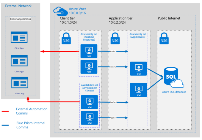

The architecture guide refers to Runtime Resources and Development Clients, but not really Interactive Clients:
And when I came to the installation of Blue Prism on the VMs, it refers to the Runtime Resources and the Interactive Client, which threw me a bit.
My question is, assuming I have the smallest possible network setup, which is the VM that will be doing the actual work i.e. which one will the automation be whizzing around doing processes on with no human interaction?  Is it the runtime resource?
Is the Interactive Client just for externally 'spying' on the runtime resource to see how it's getting on?
And then the dev client is for creating new processes effectively offline?
