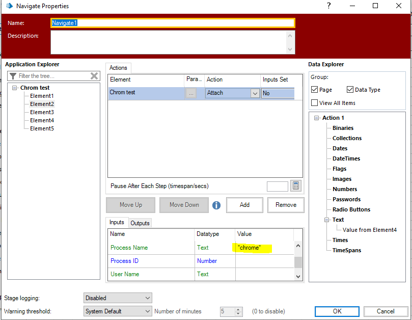

Hi Perry,
I am trying to attach using the process name as "chrome" and child index as 0 and it's working for me.
The process I followed was I launched the browser manually and trying to attach using blueprism.
Amlan Sahoo
