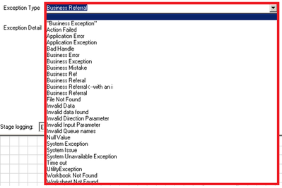

3a. - Carefully review the list of existing exception types, and select the matching one (including sifting through all the typos)
Example here:
3b. - Decide on what should the Exception Details be, and provide a meaningful message... or create an entry in a data dictionary for each new exception, and provide a reference in the Exception detail.
