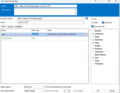

Hi @emeka.ozonze
We had the same issue, and we fixed it via the UTC Time.
Can you try to convert the time provided in UTC ?
For instance if your start date is 24/05/2024 00:00:00 convert it to UTC via Utility Date and Time Manipulation with action Local to UTC.
Do the same for the end date
And try then to run your get report data with UTC date 🙂

Hi @emeka.ozonze

Hi @emeka.ozonze,
Please follow the advice that @Mohamad_Dakkouri, I just wanted to add some useful info that you could find on blue-prism-6-date-and-time-handling
The following product design principles relates should be considered
  • For storage and data transfer, an instant in time is always represented as UTC.
  • Within the user interface, dates and times are commonly presented according to the user’s local
    time preferences (as determined by the Operating System or browser).
  • Schedule start times are saved based on the local time-zone settings of the device used to
    configure the schedule. Schedules are executed by the server based on the server’s local time.
The "Get Report Data" is expected to receive UTC Date, same applies to "Defer", "Get Exception Items" and some others. If you use "Get Item Data" , the date outputs are also coming in UTC and the approach that @Mohamad_Dakkouri said should be implemented but inversed (UTC to local).
Regards
Daniel Sanhueza
RPA Professional Developer
Deloitte
Many thanks @Mohamad_Dakkouri ! This solved it perfectly.
Many thanks, @Daniel_Sanhueza , for the additional info. This solved it perfectly.
