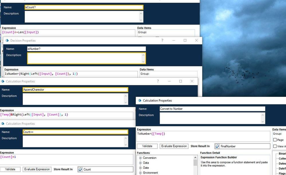

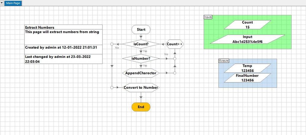

Hi Hari,
You can extract numbers from a string by using Right, Left, IsNumber Functions natively, without using code stage or Regex.
And
naveen k
And
naveen k
