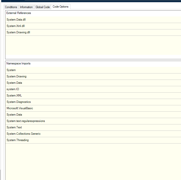

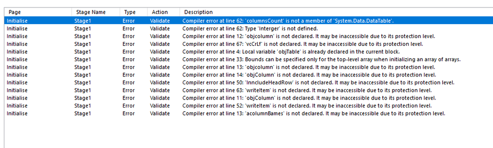

Hi I would like to add GC action in my process, but this site is blocked by my support team. So I am trying to write the code directly on the Object studio. I added all the dll on the Initialize page, Added the Global code but when I check for errors it throws me the below errors.  These dll aren't available under th e C drive>Program files. It doesn't come by default. We use 6.6 BP version. Could someone please advise on this?
Janu RPA Developer
