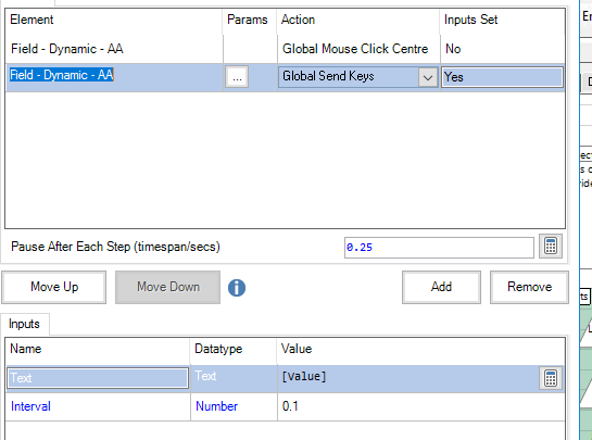

Hi there,
Is there any particular reason why Blue Prism 6.9 sometimes sends special symbols instead of provided numeric values when using "Global Send Keys"? Usually it happens for the first 1-2 symbols. For example, If I have a value "22 some text" BP would replace '2' to '@' and send "@@ some text".
If I set to use interval in between keystrokes of, let's say, 0.2sec, it would still replace the first symbol and send "@2 some text".​
Also, setting the interval somehow messed up another thing - BP is now sending a letter/digit twice. For example "30.09.2022" -> 30.09.20022" or "London" -> Loondon". Very weird stuff.

My "Write to Field" action:

Emerson, "Write" action would be great but on the current application I must use AA mode. Unfortunately, in this application "Write" action simply does not work in AA mode.
Neeraj, I haven't had @@ symbols for awhile now but I am still facing double letter/symbol issue. Using "Escape Sendkeys String" and feeding the output did not help unfortunately. 😕 Here in this example I tried writing 1234 and got 12334.
I also tried reworking "send keys" action to how it was recommended before BP v6 but it also did not work.
