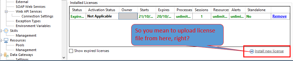

you mean to install new license by clicking [Install new license] as shown in the image, right?

Hi Pratima, exactly so. Once you have a new license file, you press this button, upload the file and it's done. You can also have multiple licenses, so you could install the new license early, before the current one expires.

Hi Pratima, no problem. Yes, as the license is held centrally, you only need to install it once (per environment) via the interactive client.
