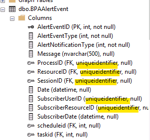

UID columns can be spotted by their data types:
Those columns do have little meaning on their own and are normally not part of a query result (except for some specific cases).
A query with explicitly names columns and omitting columns with data type uniqueidentifier should work.
In case you need those columns in the result set you have to convert them. eg:

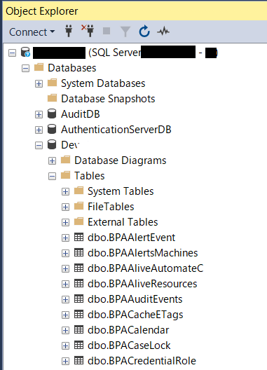

For example, if the database structure is as shown in the following figure,
select * from Dev.dbo.BPAAlertEvent
The contents of the BPAAlertEvent table should be retrieved.
However, when I issue such a command in OLEDB VBO's 'Get collection',
I get an error that says "Internal : Could not execute code stage, System.Guid cannot be converted to Blue Prism data type".
(Note: The error text is in Japanese, so the English translation may not match the error text in the English version.)

Thanks for translating the error message 🙂 There seem to be several issues.
GUID is a very specific database data type and does not exist as unified data type across programming languages and therefore is not automatically converted from DB data type to local data type.
SELECT CAST(processid as VARCHAR(50)) FROM BPAProcess
