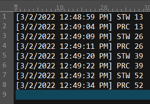

02-03-22 12:52 PM

I implemented your test scenario. I set the run-mode of each object to Background and I checked the Shareable flag on the Singleton Test Server VBO. After running the test, here's the output in my log file:
