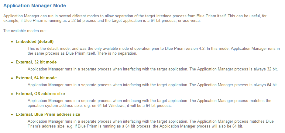

After speaking with Blue Prism support I found out that they only have 32 bit installs of blue prism. This means that it can only use a max of 2/3GB of memory.
This has been causing a problem with archiving larger data files from the Blue Prism logs. While building we have all logging active which means some of the sets of log data can be quite large. When trying to manually or automatically archive this data, the process fails due to not enough memory, even though more memory is available on the resource running the archiving.
My suggestion is that in a later update of Blue Prism, a 64 bit process install should be available. This would allow more memory to be used, and stop our Robotics team having to rely on a Data Base Admin to archive our data for us.
If anyone has any other suggestion on how we can get around this I am happy to discuss.
