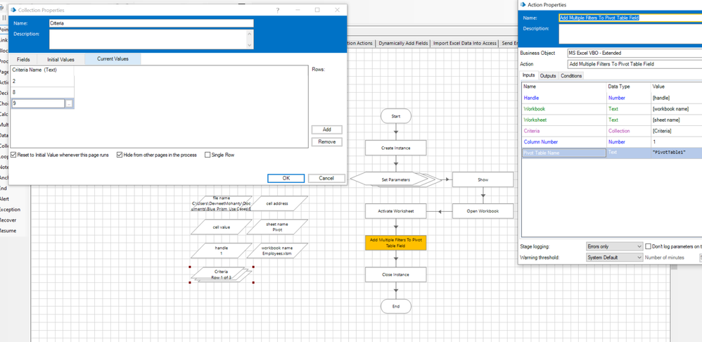

Now, publish your action and then use all the actions of the same business object where you have done the changes in your process studio while interacting with the excel file in order to avoid any exceptions. I have a sample process studio workflow shown below:

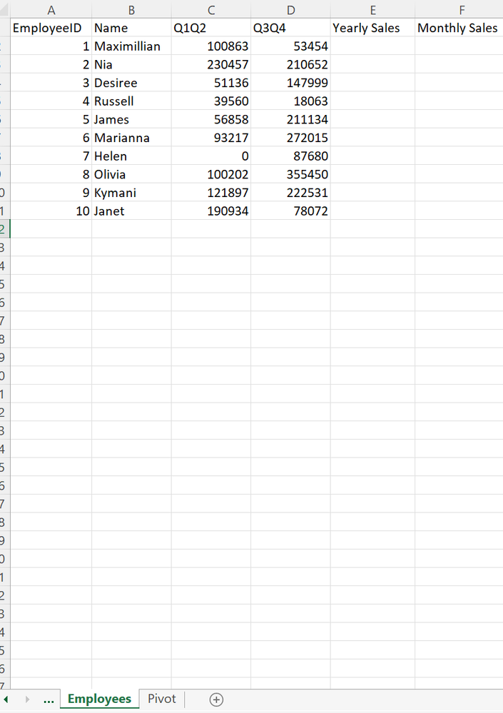

So just to explain you a sample scenario which I have picked up, I basically have an excel file with below original table data:

So what I want here is to add multiple filter values for the employee ID field (which is the column number: '1' in my original dataset) which would be 2,8 and 9 respectively. Hence, I am creating an excel instance, then opening my excel file, then making it visible on the screen and then I use my new created action which has the below parameters:
Post execution of the workflow I get the below results:
So here as you can see you can provide as many values as you want in different rows of your criteria collection with appropriate column number and pivot table name to have multiple filter criteria selected.
