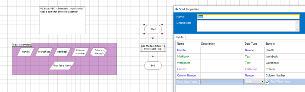

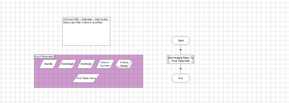

Now, you need to create a new action in your already existing Excel VBO business object named 'Add Multiple Filters To Pivot Table Field' and provide the following input parameters to your action:
Handle : This is a number type data item which will hold the current session dictionary value.
Workbook : This is a text type data item where you need to pass the workbook name that you might get from 'Create Workbook' or 'Open Workbook' action.
Worksheet: This is a text type data item which indicates the name of the worksheet in your excel workbook file where the pivot table exists.
Column Number: This is a number type data item which indicates the column number in your original dataset from where you have created the Pivot table. The column number begins from 1 to N.
Pivot Table Name : This is a text type data item which indicates the name of the Pivot Table.
Criteria : This is a collection type data item which consists of a single column called as 'Criteria Name' of text data type and this column will consists of all the filter values that you need to have in your page filter in each individual row.
Now, you can add a code stage named 'Add Multiple Filters To Pivot Table Field' and add the following inputs parameter and map the data items to it:

You should have your workflow ready as shown below:

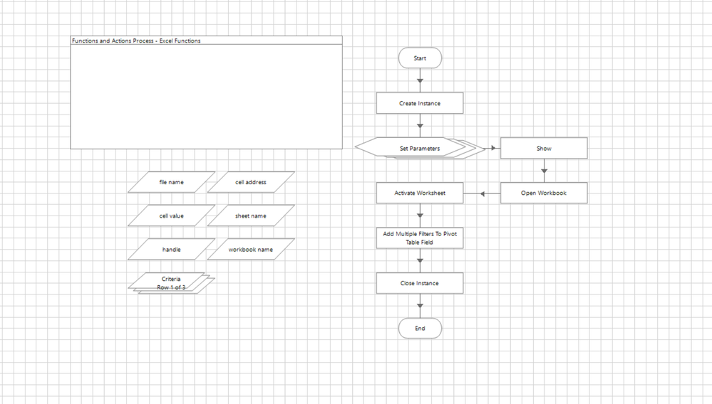

Now, publish your action and then use all the actions of the same business object where you have done the changes in your process studio while interacting with the excel file in order to avoid any exceptions. I have a sample process studio workflow shown below:
So just to explain you a sample scenario which I have picked up, I basically have an excel file with below original table data:
I have also created a pivot table with the name, 'PivotTable1' before hand from start in a separate sheet called as 'Pivot' as shown below:

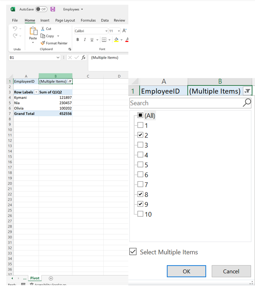

So what I want here is to add multiple filter values for the employee ID field (which is the column number: '1' in my original dataset) which would be 2,8 and 9 respectively. Hence, I am creating an excel instance, then opening my excel file, then making it visible on the screen and then I use my new created action which has the below parameters:
Post execution of the workflow I get the below results:
So here as you can see you can provide as many values as you want in different rows of your criteria collection with appropriate column number and pivot table name to have multiple filter criteria selected.

Thanks you for your solution But i have doubt in your proces why you are used multicalc stage there in your process as set parameter. can you just just share the screenshot of your multicalc stage.
and your response really help me in my project. Thank you very much!​
Tejashri Nevase
Hi @Tejashri Nevase
I have used multi calculation stage in order to set up my file path and sheet name which I am going to use in my actions going forward. This you can also maintain in an environment variable or a configuration file as well or simply hardcode the values.
​As you can see the file path of my excel file and the sheet name that I have set are then just simply being passed over to the below actions in form of a data item:
