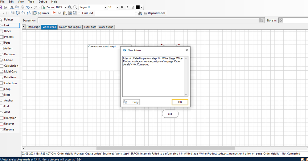

 Can anyone help me with the below error. I am trying to enter the product details from excel to centrix data solutions. But I am getting an error as the "Writer stage Product code is not connected" as internal error.

HI Sravya - 'not connected' means the VBO is not attached to the target application, and as such it does not know where the application is and cannot interact with it. If a VBO is the one who launched the application, then it is automatically attached. But if a VBO isn't the one who launched, then it must attach itself to the application in order to be able to interact with it.

  Thank you for the reply. I have attached the application before starting the process. Still, I am getting the same error.

Can you check if its already attached ? it is a best practice to use the IsConnected function in the Reader stage. If it returns True then no need to Attach and if it is False only then Attach it.
