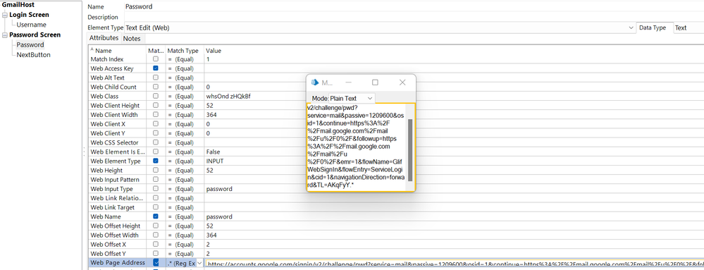

Hi everyone im quite new to using BP and am trying to make a bot to log in to my gmail
I keep getting this error when navigating to the password page
No element matched query items
I know its because the Password element has a web address attribute that changes the last 10 characters everytime it launches but I dont know how to use Regex/dynamic attribute to solve it

Have you tried just using the attributes: 'Match Index', 'Web Element Type' and 'Web Name'
Couple of Quick Notes:
- Always ensure you do not select blank attributes in your element's attribute list.
- Try to avoid using attribute which can really change dynamically. With regular expressions and wildcards there are only a a number of scenarios which you would be able to handle. If there is no need of using such attributes, best approach would be to avoid them altogether.
- Use of Match Index attributes always help whenever similar type of elements can occur in your automation.

Yup that worked like a charm!
Thank you so much Devneet I know it was probably a beginner question but it was something I was quite frustrated being stuck on thanks for your help:)
