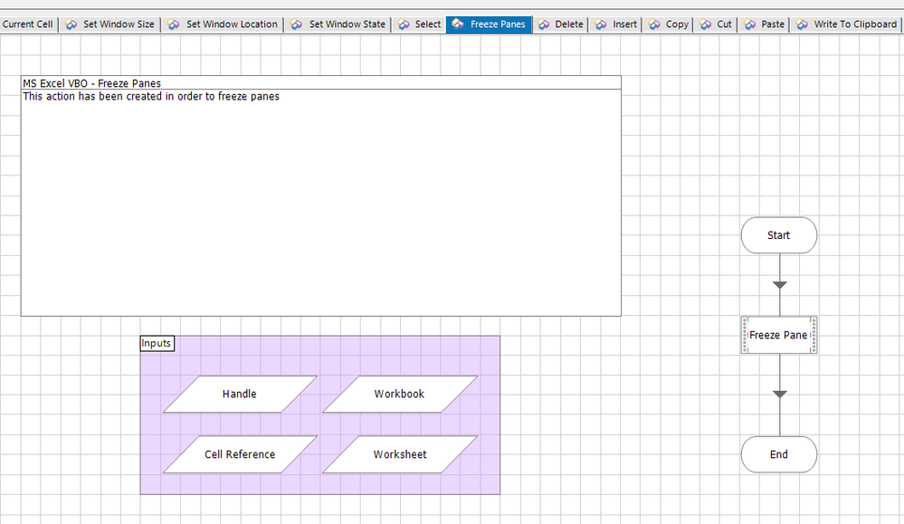

Solution Workflow:
![32043.png 32043.png](/t5/image/serverpage/image-id/32154iE486D6AB1812A5F0/image-size/large?v=v2&px=999)
Add the code stage named
'Freeze Pane' with the following parameters and code:

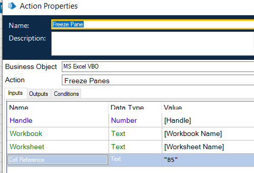

Test Scenario:
I have created a workflow and provide the parameters for 'Freeze Pane' action as follows in the process studio:
![32046.png 32046.png](/t5/image/serverpage/image-id/32158iABC872D80B174CD7/image-size/large?v=v2&px=999)

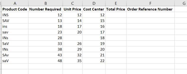

NOTE: Ensure that all the actions are used from the same VBO where Freeze Pane action has been created in order to avoid unexpected errors.The input file before execution looks like below:
![32048.png 32048.png](/t5/image/serverpage/image-id/32160iA3AF856C6CD4106A/image-size/large?v=v2&px=999)
Upon executing the workflow, the results are as follows:
![32049.png 32049.png](/t5/image/serverpage/image-id/32159i2B692E063B603B67/image-size/large?v=v2&px=999)
Here, the freeze pane has been added at the given cell reference.
