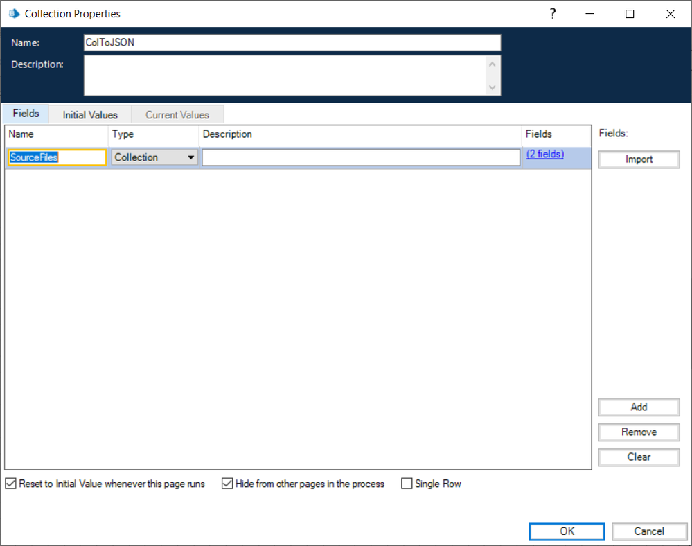

What we have below is a top-level Collection with a single field titled

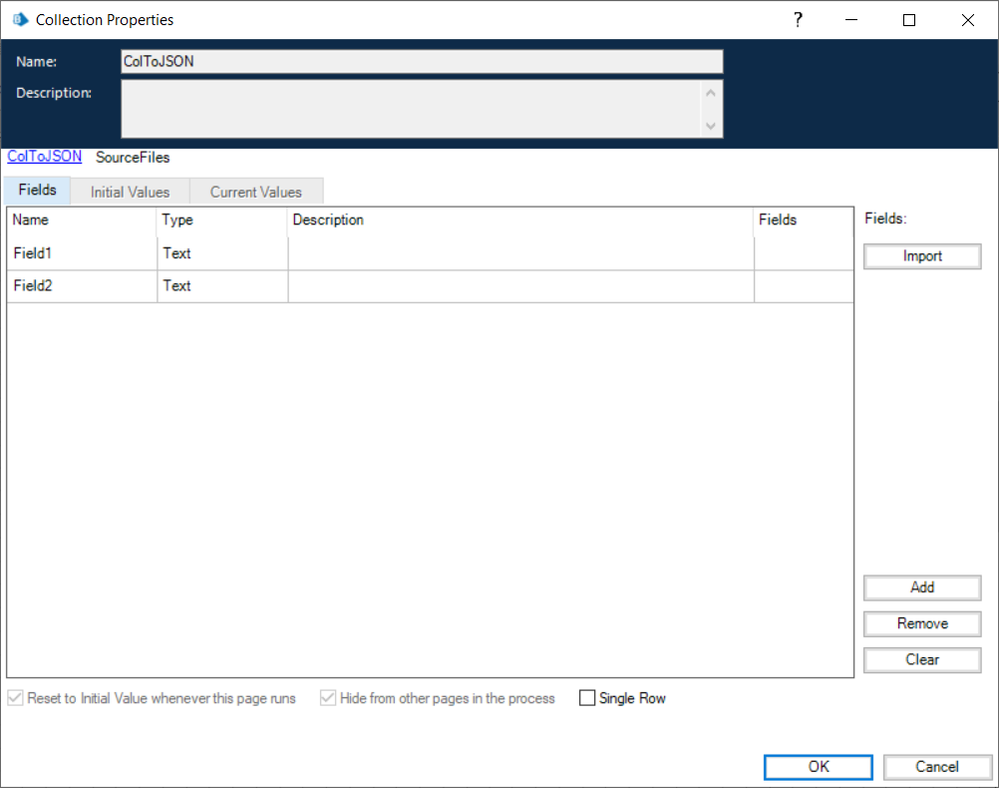

SourceFiles with a field type of Collection. That Collection then has it's own definition which is two fields named
Field1 and
Field2 each with type Text.
Collection Definition![31949.png 31949.png](/t5/image/serverpage/image-id/32070iEE893546CB4F15EF/image-size/large?v=v2&px=999)
![31950.png 31950.png](/t5/image/serverpage/image-id/32072iDF4C8BC5AE2A679A/image-size/large?v=v2&px=999)
When we run this Collection through the
Collection to JSON action, we receive the following JSON as output.
"SourceFiles": [
"Field1": "SourceFile:Row1-Field1:Row1",
"Field2": "SourceFile:Row1-Field2 Row1"
"Field1": "SourceFile:Row1-Field1:Row2",
"Field2": "SourceFile:Row1-Field2:Row2"
Since you don't want to top-level array definition, you could always remove the top-level brackets with simple string manipulation.
