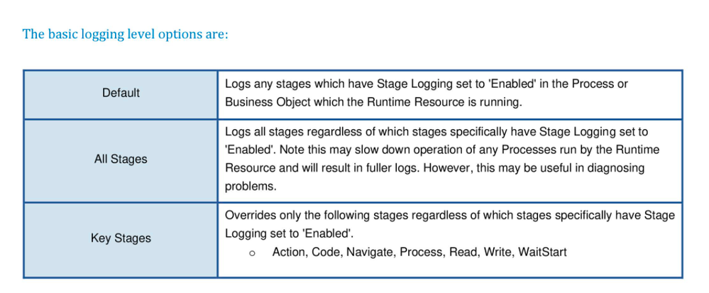

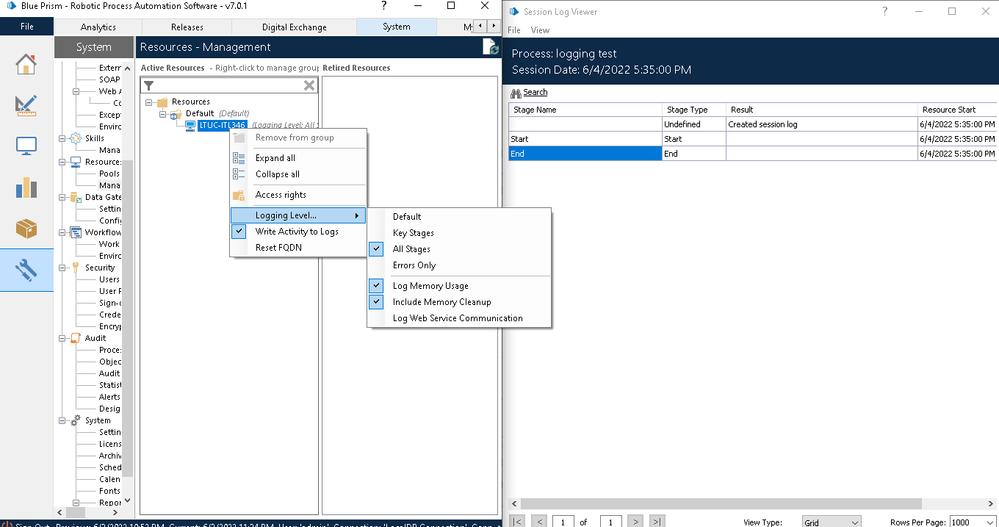

36561.pngit's written that "It is possible to override the stage logging settings which has been assigned in a process or Business Object, by setting the logging level at Runtime Resource/Digital Worker level.This means that each Resource can have its own logging level defined."
but I have tried this option and I still can't view logs yet

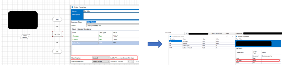

Let say I have a process with only one action where I am setting the logs level as 'Enabled'. Now when I run the process post publishing it in the control room, I will be able to see the logs on that action stage in the Session Log Viewer wizard as shown below:

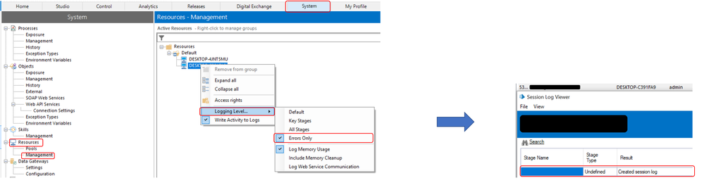

Now, I go to my 'System' tab and under 'Resources' section I click on 'Management' and then select my runtime resources and right click on it to choose the logging level as 'Errors Only'. Now, if I again run my process from Control Room you can see that I am not able to view the logs on my action stage which I was able to do before as shown below:
This is because my settings for logging have been overridden at a runtime resource level.
