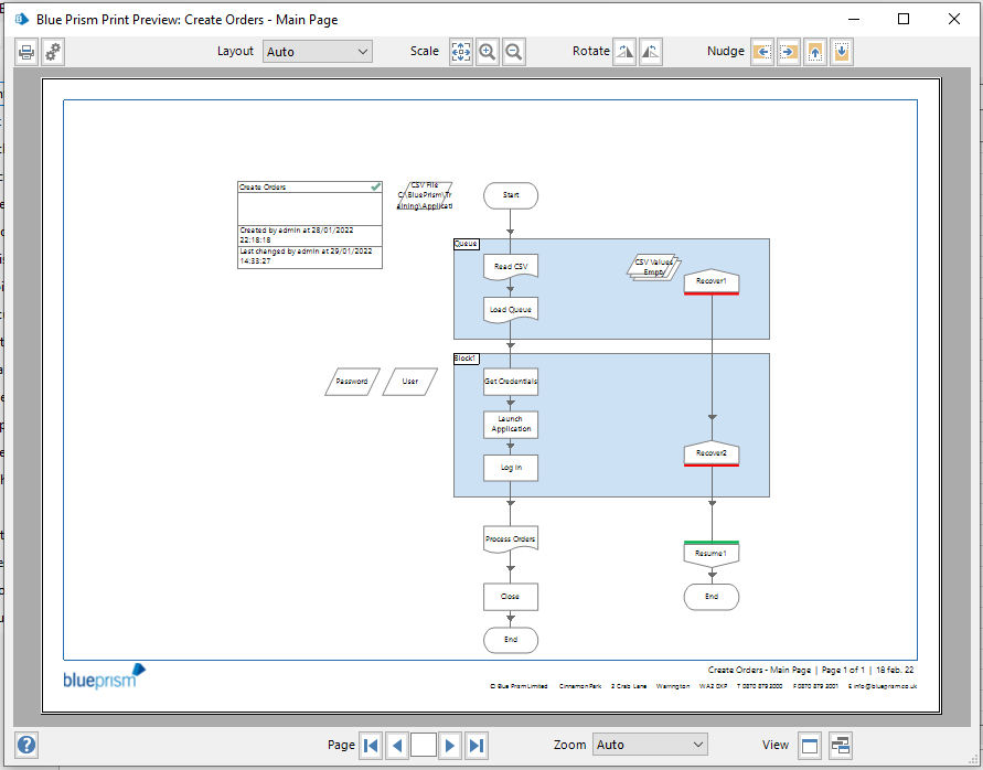

- Print the entry pages of the Process: By opening the Process or Business Object go to the top menu, File >> Print >> and then the option that you prefer.
The preview of the export looks like this:

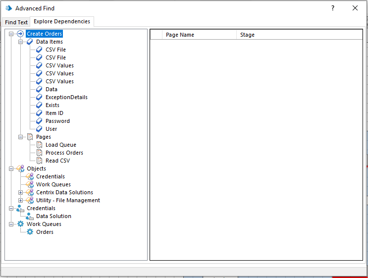

Also, you can know the all the dependences in your diagram. With the Process open, go to the top menu "Tools", and the choose "Dependencies". This gives you an entry tree of all pages and object that you use in the solution. Looks like that:
Hope this helps you with SDD.
