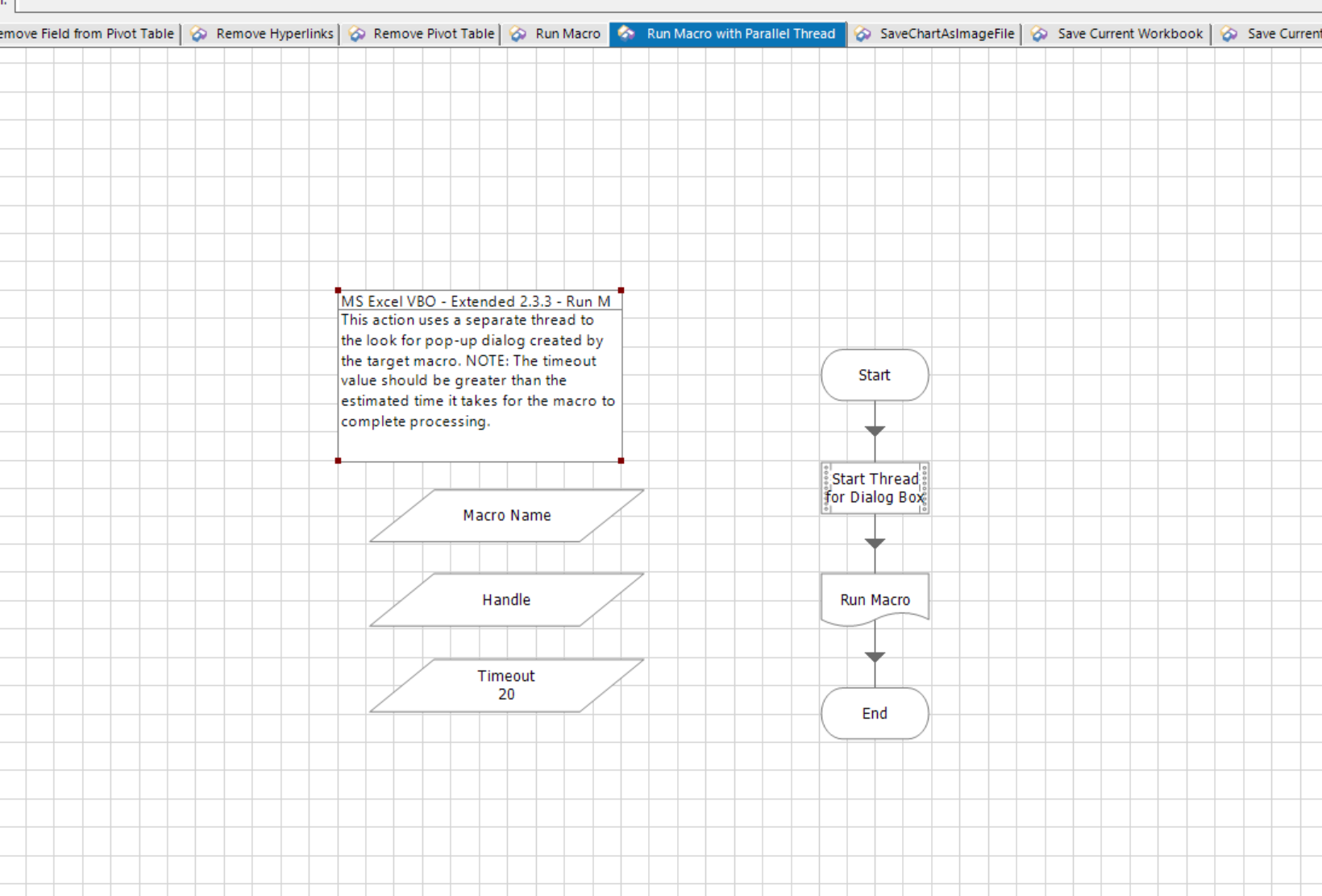

This likely will happen as when you call Macros they run on the same thread as Blue Prism. So if any popup will appear then your bot execution will also stop. The ideal way to handle such issues is at the Macro end such that you create a function which returns some error message via Error Handling to resolve those popups back to Blue Prism in order to figure what the issue was at Blue Prism end and you can then take the necessary steps.
The other thing which you can try is to go with the latest Excel business object at DX Exchange:  MS Excel Extended
Here you can use one of the action called as 'Run Macro With Parallel Thread' that basically runs the macro code as a separate thread call instead preventing your bot execution to get halted. Below is the sample action:
