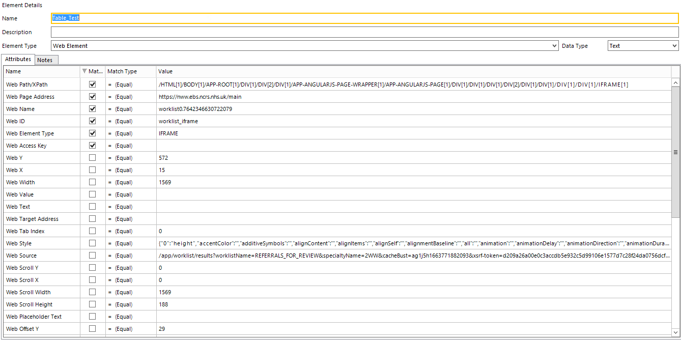

We have just swapped one of our Automations from IE to Edge and having trouble getting table items from within an iFrame.
Previously with IE we could just HTML spy the table and use 'Read' - 'Get Table' and place the results into a collection, however now with Edge the same element is being spied as iFrame and when using 'Read' we are unable to 'Get Table'.
Element Details of Edge spied table element:

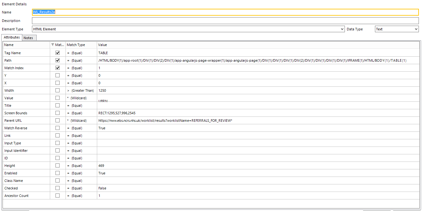

Same Element but on IE:
I have tried changing the Element type to 'Table (Web)' and get the below message when trying to read/get table items into a collection:
I have also tried changing the Element Type to 'Table (Web)' coupled with changing the Web Element Type attribute to 'TABLE' and still no joy.
Is there a way of grabbing the table within the iFrame and sticking the results into a collection?
