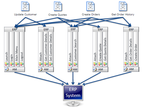

18-12-19 01:33 PM
Every Object must have the Attach Page, see the example below.
As Developer in every action of the object I put a Page Stage referencing my Attach Page right after the Start Stage.
Hope it help
