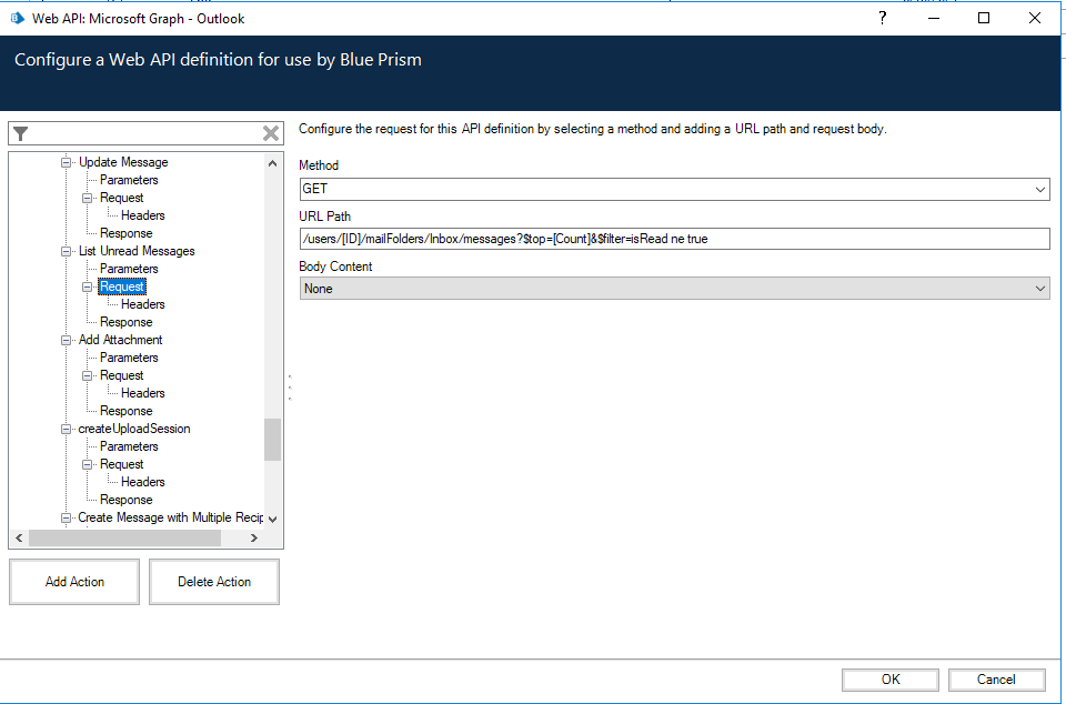

I'm not seeing the behavior you describe. I've changed the definition of the standard List Messages action to replicate what I think you're doing, and I'm getting back results. Can you post screen shots of you action definition?

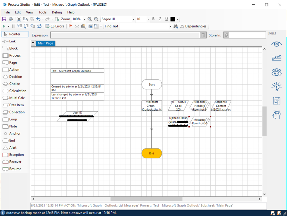

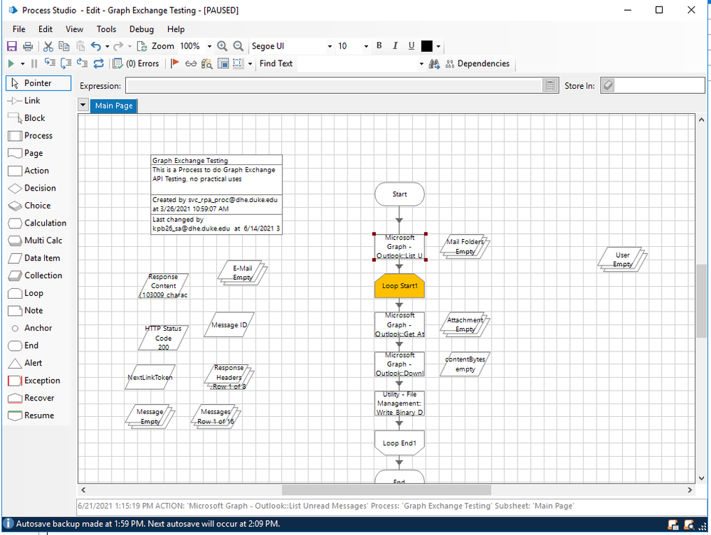

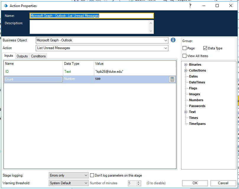

Thanks Eric.  Below are my pictures.  Again, it appears that the issue is in how Blue Prism handles the result set since I get different results from different mail boxes.

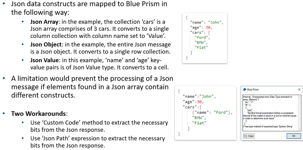

bruce.liu
I have come across this limitation quite some time ago. I have summarised this in a slide deck below for your reference.
