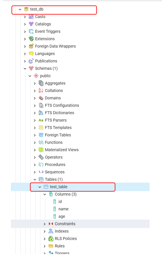

Step 2: Create Table & Database At PostGreSQL Server:
To test if everything is working, I have created a sample database called 'test_db' and a sample table within it called 'test_table' in my PostGreSQL server using the PgAdmin client:
