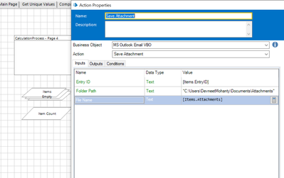

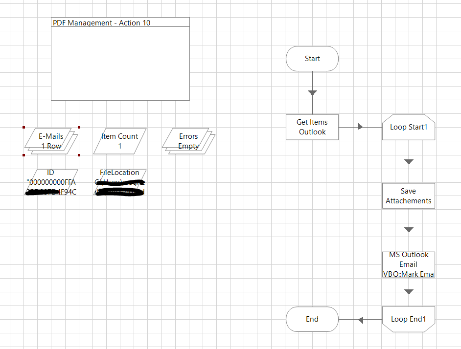

Hello, I am currently trying to save all attachments of my unread emails in a folder. I am using the Outlook VBO and the action 'dd'. There I enter the filepath and the filename, unfortunately the whole thing doesn't work. Regardless of whether I save the name ("file.pdf") in a data item with a text attribute and without "" or directly in the action with "file.pdf", this is always skipped and not saved. What could be the reason for this? If i leave the "File Name" entry empty, it does work. This is my process.Unbenannt.PNG

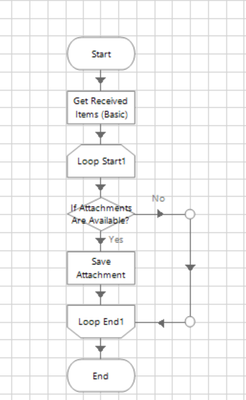

  2. The 'Save Attachment' action does not throw any error even if your email does not have any attachment at all so it may be possible that your action is being run successfully but the current email in your loop does not have the associated attachment at all. My suggestion would be to first modify the section of your workflow as shown below which will check the existence of attachment prior to the action itself and check where the workflow goes:
  3. Also, can you show us the action properties that you are using. In my case, the action works when I use the attachment name coming from the email itself. If you use a static parameter let say something like "file.pdf", then in every iteration the attachment will be saved using the same file name which will result in overwriting the file saved in the previous iteration so you will ultimately end up with only one file. My suggestion would be to use the parameter as shown below if possible or somehow make your file names dynamic so that they do not get overwritten:

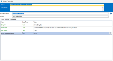

If I understood correctly when you try the Save Attachment action it doesn't work when you put ("file.pdf") in the filename field. If you want to save pdf files you only need to put "*.pdf" in filename. See below the documentation :
Try to use Save Attachements and provide inputs like this :
I hope it will help you :)

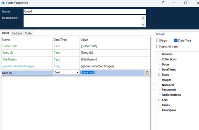

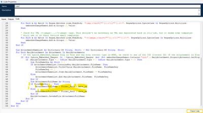

If you want to change the name with which an attachment should be saved instead of original name, you will need to modify the code a stage a little,
Add an additional parameter lets says saveas and modify the code stage sth like below.
