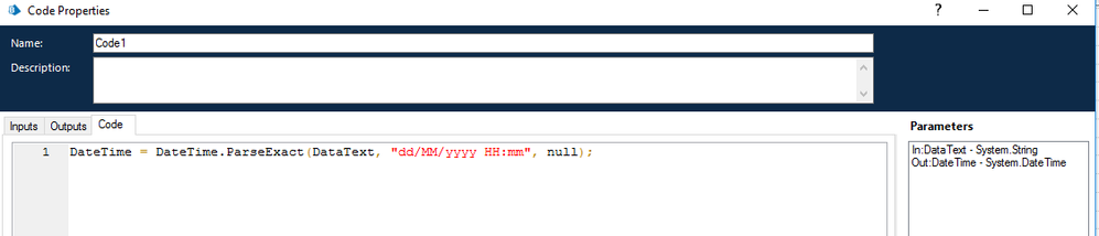

Dear, I got this message when capturing this DateTime from a table. Does anyone know how I can resolve this?

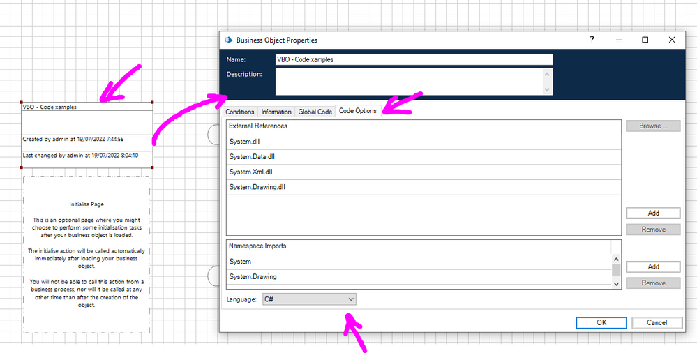

Hi @RafaelGuerra
Try this two thinks:
- The name of the variable that you have as output parameter is DateTime, but "DateTime" is a key word from C#. Edit the name, for example "datDateTime" in both parts, in your code and in the output tab.
- Change the language of your VBO to C#. For this, go to the Initialise Page, double clic on the properties, and go to the Code Options tab, here change the Language to C#
Hope this helps you!

Hi @RafaelGuerra
For this is better to use parse function.
Here you have the code to translate the text to the DateTime in your format:
For my example, datTime is the DateTime data item, and strDateTime my text source, Put this in a VBO using C# and is done
See you in the community 🙂 Saludos
datDateTime = DateTime.ParseExact(strDateTime, "dd/MM/yyyy HH:mm", null);

29-07-22 03:12 PM
Dear Pablo, would that be a suggestion?
I've never needed to do a solution like this, so I'm really confused.
When I checkcode it gives an error.
